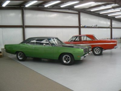

A 'good' set of heavy duty shocks does what to the shock crossmember? What will 20 psi do? I've been doing this stuff for years. I guess I live in an area where rust isn't a big problem because I've never seen an upper shock mount get pulled out...but I live on the Texas coast where rust is an issue. This must be a rust best problem..... :D
