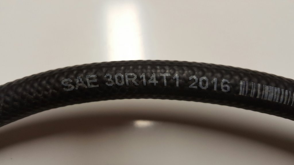

Isn't the newer fuel hose a silicone? I bought a section of it for my build from NAPA. I'm not home right now but I'll post the part number later. I want to compare it with what you have been using. They told me it was for the ethanol fuel.
"Not for fuel injection" written on the hose also. The sales person told me that its good for ethanol up to a certain percentage, like 20%.
I've been hearing about different hoses not holding up. Would like to make sure what to use.
View attachment 417725 I've been hearing about different hoses not holding up. Would like to make sure what to use.
I'm going to get my road runner from storage in 2 weeks so I'll let you know what I had in there but it looks just like that, but now it's got cracks along the hose. I might just try some black braided hose.
