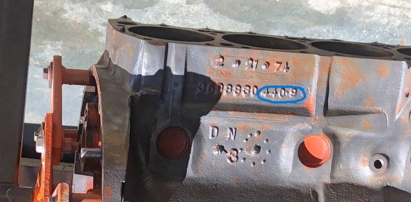

If the engine block is an original 400, it would have been cast between late 1971 and 1978. The 383 went out of production at the end of the 1971 model year. The engine block will have raised letters and numbers on it like so:
This is the right side of the engine, the passenger side. Circled in BLUE is where the engine size is cast. Above it is the date that it was cast. In this case, this 440 block was cast February 21st 1974.
Being an "H" code, that tells what the car originally had for an engine. It could be anything now. The numbers on the block will tell the story.

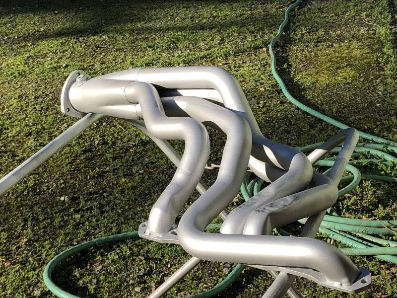

"Headers" are these things:

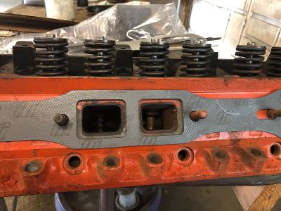

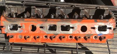

They are replacement upgrades for exhaust manifolds and are made from tubular steel. They do not get "ported" in most cases. What can be ported are the heads themselves....

Thanks for the pictures! I’ll look for the code on the block.
