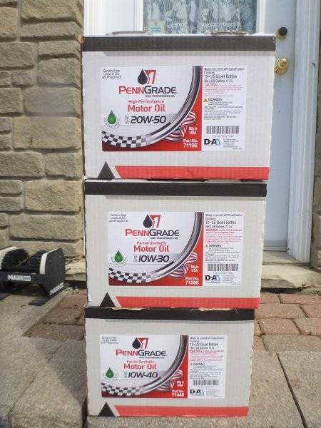

Nice to know you can get it up there. Summit?
