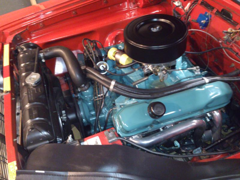

no gaskets here....TTI:eusa_pray: a prayer and a dab of high temp RTV silicone
