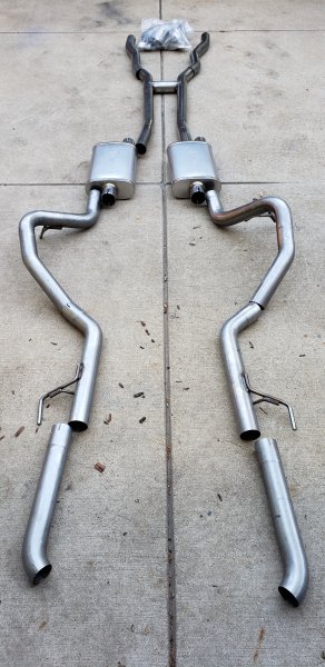

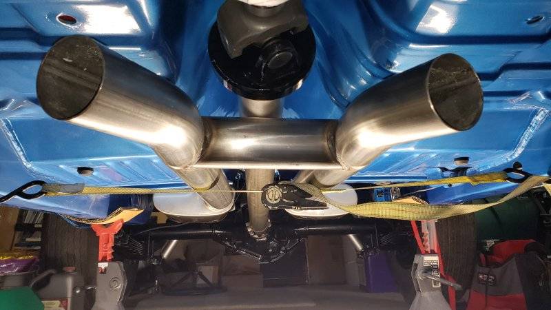

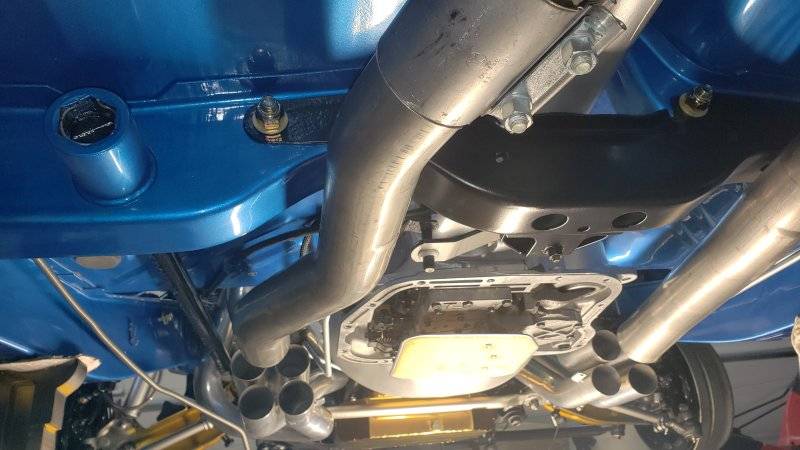

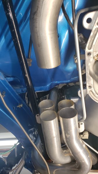

I can't tell you how it sounds because mine is not running yet but I went with the Holley/Hooker Blackheart
system. It's all 304 Stainless and would be perfect for your app. I added two Stainless reasonators in the back
and it will last forever. It comes in 2.5" and 3". I went with the 2.5 as per the Mopar engine manual rec's. Got it at Jegs.
Check out the pic's.
