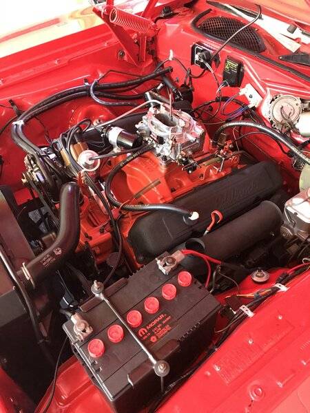

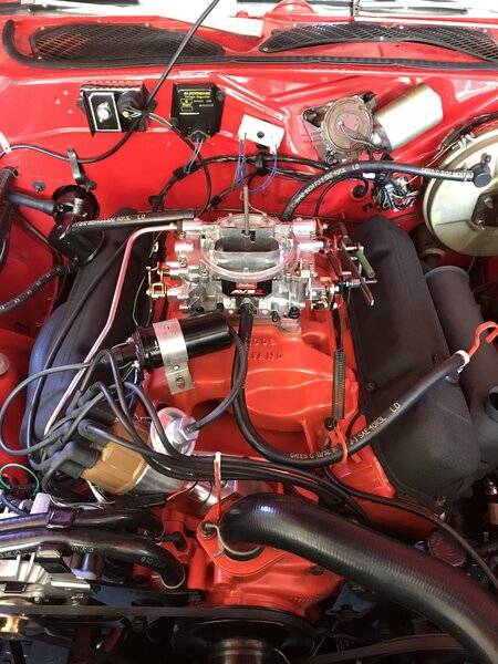

I run the 800cfm AVS-2
383/432 Edelbrock E Street 75cc Heads
View attachment 1080274View attachment 1080275
Is that the 19063?

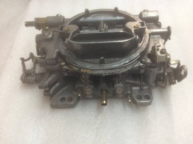

Got a for sale ad for a 600 cfm eddie. Clean it up an add gaskets. All gaskets removed and pretty sure I cleaned gasket surfaces. $50 plus shipping.
