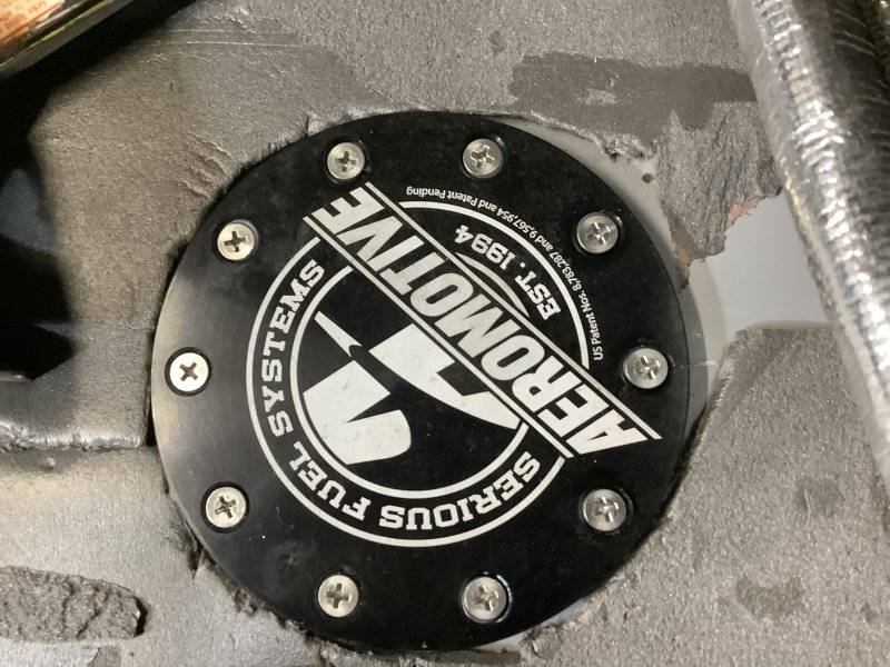

hear is 2 of them

hear is 2 of them

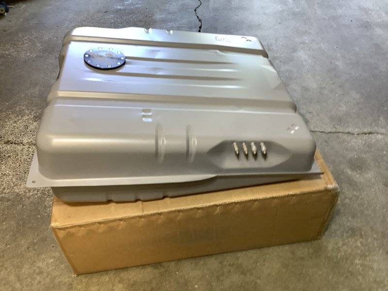

Cool, good to see other companies stepping up for those cars.
X2. Unfortunately I don't know of any EFI-ready tanks for '71-up cars.

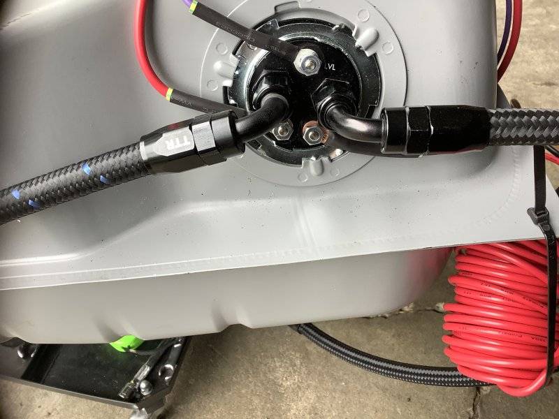

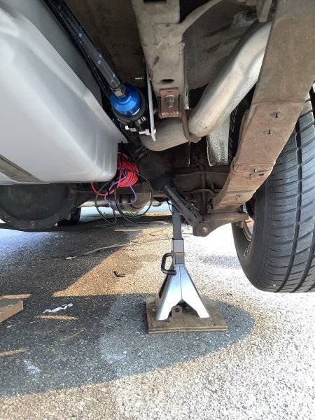

I put an Aeromotive efi tank in my 74 Charger along with sniper system. The 10 micron filter is riget next to the tank. When the original Aeromotive pump died I was able to mount an external pump with the filter until I got the replacement installed.
