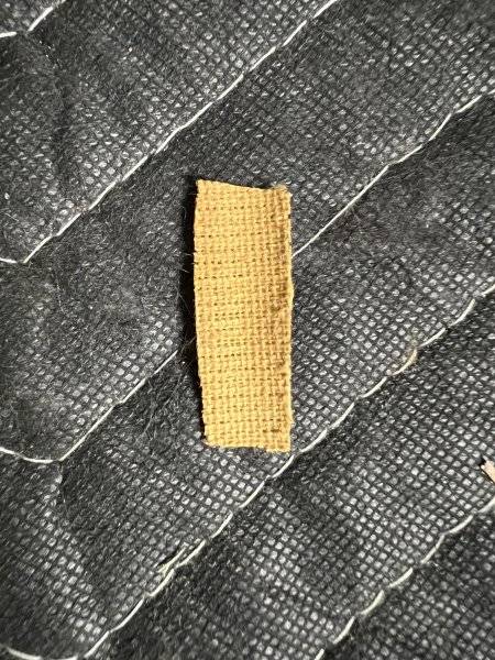

I am not sure what the color name is however the interior code is E6Y4. The headliner is cloth and has almost a yellow orange tint to it. I'm guessing its supposed to be a shade of gold to go along with the honey gold interior. Picture attached but its hard to really tell from a photo.
