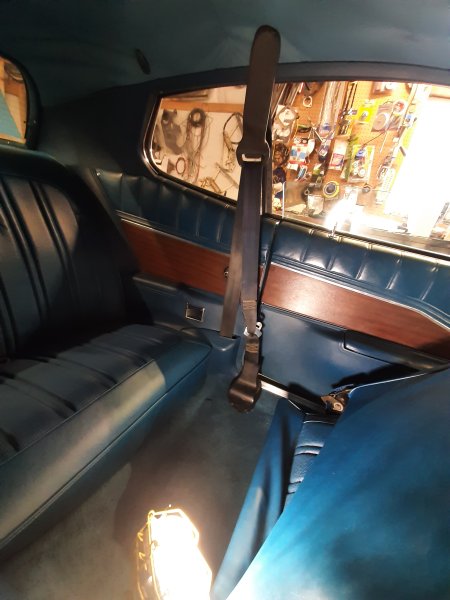

I had the same problem with the carpet in my 74 Charger. I reoved the carpet from the box and installed it right away in the car. I placed heavy carboard and a tarp over it and then installed the rest of the interior while kneeling and in general working on the carpet installing the headliner, dash, steering column, panels, etc. over the next 12 months. By the time I was done, it was showing no creases. I installed the seats last. It looks great. If you don't have the time, then steam it.
