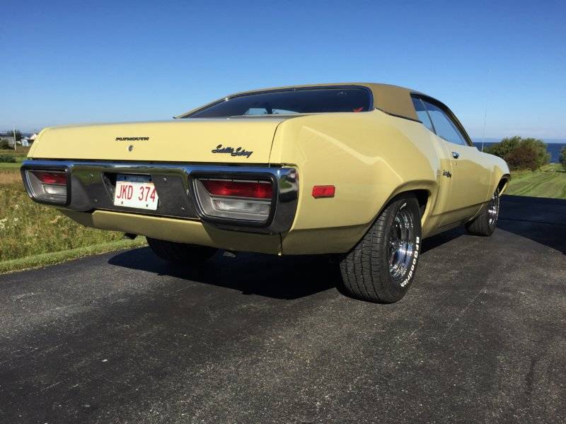

Depends on what you use your car for. Mine is a driver with a mildy built small block and I installed the Mopar HD springs. I paid about $250 for the springs alone about 10 years ago. They worked out really well with a perfect stance. I run 18" wheels so your results may vary.
I'm also using Mopar HD springs. Very happy with them.
Nice stance also.
