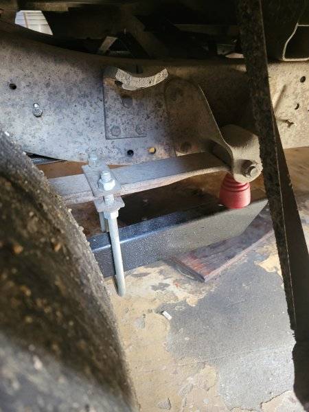

leaf springs look ok? shackle has some angle but too much?
Got fast reply from Laura at ESPO.. the stock shackles were 3.5" center to center (so guessing less than 5"?) so mine are certainly longer shackles, gave me some options on springs to go with

OP needs to understand, if the OEM shackles were exactly vertical, they would be loaded mainly in compression, their lightweight design is not ideal for that loading, once they are past over center, they are started to be loaded in tension, and their design is more than adequate for that loading.

Yikes those slapper bars that far down would scare me!
I don't know if they would "scare" me, but they sure could be installed better. IF they are the cheap summit style, with just a couple u-bolts, they should be slid as far forward as possible. If they are the lakewood style that replaced the spring pad, I would certainly lengthen the arm so it hits under the spring eye, instead of six inches behind it like they are now.

All kinds of scenarios like hitting speed bumps, potholes, you name it.. was where I was headed.
Buy yeah , up, forward, and some sort of retention as per nhra would be good

1970 gtx i just bought, no rebuild documentation was provided, decent "driver" quality i think. paid a bunch, had Dave Wise MMP detroit inspect prior to sale and gonna have a few touch up items replaced, but rather than just doing new bushings on the leaf springs, would replacing the leaf springs give me 1-2" lift in rear i'm looking for?
read a bunch of threads on here and should this angle of the shackle be of concern? there's 1/2 tank of gas, nothing in trunk not even a spare tire. leaf springs aren't flat, but not much curve to them. leaf count is different on both sides, but reading this is normal?

EDIT: the shackles are 7" long, is this typical? or are they likely aftermarket/homemade?
new EDIT: Laura at ESPO springs did indicate that these are NOT stock, that the stock shackles are 3.5" center-to-center.
Your shackles are not original and should be replaced. These were available to raise the rear of cars in my day. The problems with them is they are to long and since they have bolts, they could be over tightened and will allow the spring rubbers to wear out and soon you will have a sway in the rear and metal on metal rubbing. The original did NOT have bolts. The plates were cupped to allow the rear spring rubbers to sit in the cup area and the shafts were welded to one side and threaded on the other. When you tightened them down they could ONLY tighten so far as they were designed to STOP, preventing the rubber inserts from being destroyed.
agree with this. may go with new springs and new oem shackles just would like the rear height at LEAST where i'm at now. the longer shackles at least did bring up the rear a bit, but potentially due to the leafs having lost some curve.
