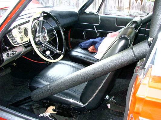

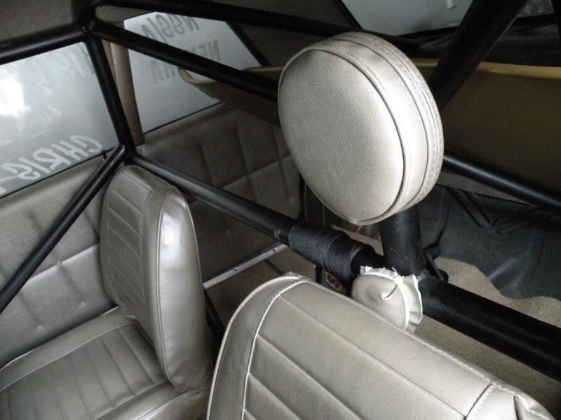

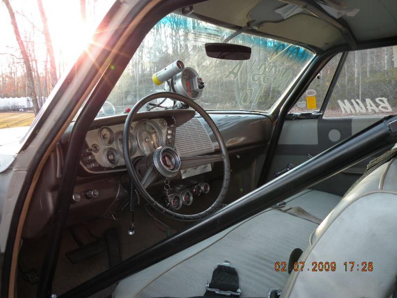

Thats depends alot on you. I have a 6 point bar setup in my 63 as its legal down to 10.0 with the stock firewall in the car. But I drive it much more on the street then I race it and I did not want to worry about banging my head with a full cage so I went with the 6 point bar and have had no problem hitting my head. I did not use removeable side bars as I wanted it to help stiffen the car and I can easily slide over my side bars. But if you mostly race you will have a helmet on most of the time and may want to go with a cage. Ron

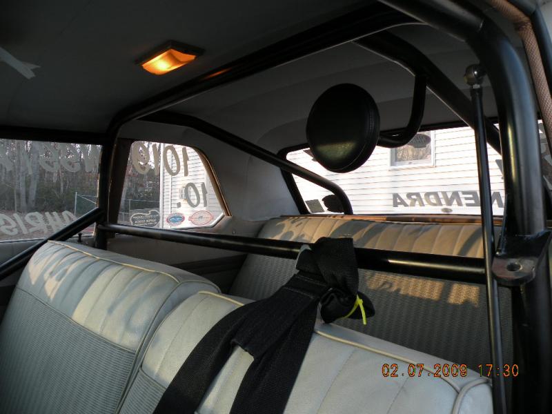

Hey Ron,
Do you have a shot of the back bars and how they fit down past your rear bench seat? Is yours welded to the floor pans with the plate?
I have been thinking of putting a 6 point in mine, because they're going to tell me to go home at the strip without one.... OOPS!

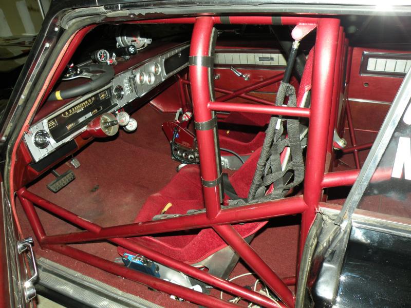

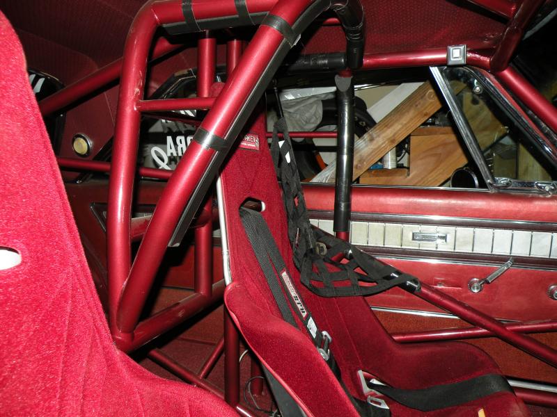

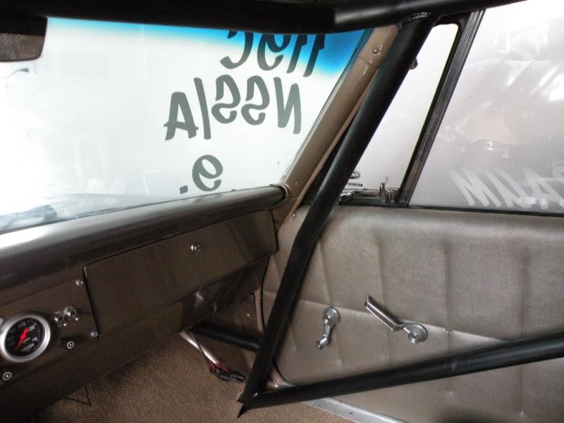

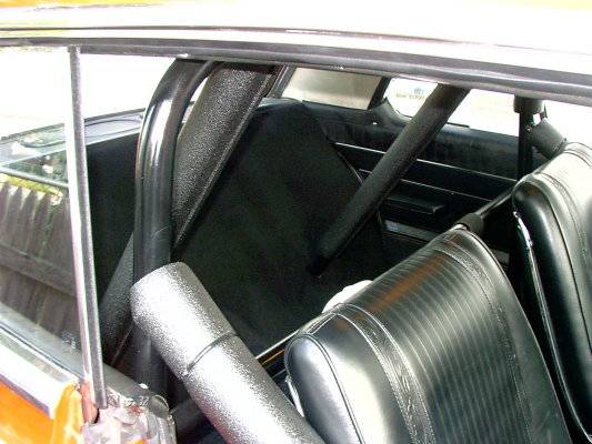

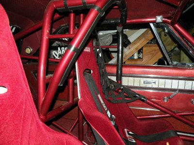

how about mine.
or more extreme.

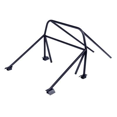

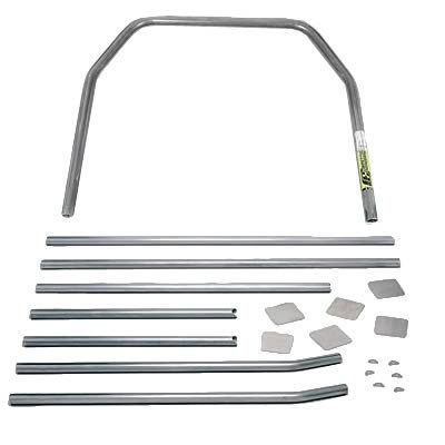

For just a simple 4-6-8-10 pt roll-bar or cage Compiteition Engineering sells a cheap "mild steel" cage "B-Body Mopar kit" type set-up too, bars prebent & notched, you cut some lengths to fit {shown below}... I like Chris Alston Chassis Works myself, I only lived about 15 miles from their old shop, I knew the shop formeman Jim B. very well at the time too, they aren't the cheapest, you will probably need to give them either a drawing & some demensions for them you build you a custom cage, but a 4-6pt Roll-bar is a slam dunk... Snakeoil24 pretty much covered what all to do..., Good luck & have fun, keep us posted, on the progress....

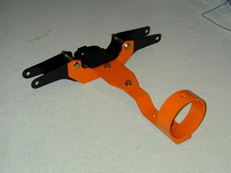

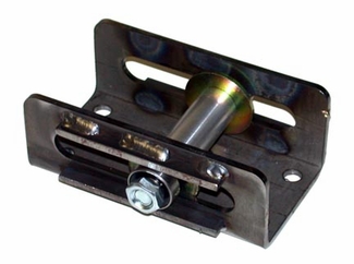

CalTracs & roller sliders front spring mounts {usually on the front on Mopars}, both are cheap & easy to install or adjust & work very well up the around the mid 8 second barrier with simple leaf spring suspension, with good double adjustable shocks... you can fit about a 13" tire with the set up, done properly... more than adequate for a 68 Charger w/500hp..

Hey Ron,
What I wanted to do was have the rear bar go in where the seat cushion meets the seat back as I have seen that before. So I used the 6 x 6 plate and welded them right over the frame where it starts going up behind the seat back. I also welded the front plates over the frame and the centers at the rocker panel as thats the strongest point there other then going thru the floor to the frame connector but my bar did not line up with the frame connector. Problem I had was I could not fit the seat back or cushion back in as it would not go between the bars. I thought about cuttint the seat and cushion metal frames to get them in but then I realized I dont think many if anyone will be crawling under the bar to get in the back seat anyway. So I just put a sheet of metal there between the sat back and trunk area and put carpet over it. I know I cant climb back there as I have to get my son to get back there and clean the window. I really feel the 6 point bar strenthed the car more then the frame connectors did. Ron

The 8 point is like what I use only I dont have the 2 bars from the main hoop to the trans tunnel. No one has ever told me I had to have them as years ago it was that a 6 point bar was good to 10.0 but I see they say the bar must be supported forward and lateral which I would assume lateral means the 2 bars to the trans tunnel which I never put in. But in the 70's they said the 6 point bar was good. And I have raced my car many times and no tech inspector has ever said anything to me about the bar. I dont see where it says it has to be an 8 point bar but I assume thats what they mean when it says lateral support ? Ron

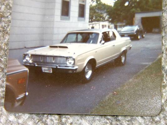

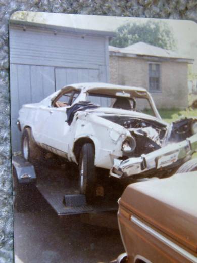

Here is how my 6 point bar held up when I rolled my old Dart 6 times in 1982. And I welded it in myself. Ron
Another shot. You can see it bent some but it held up. Ron
This pic was taken 2 weeks before I rolled it. Ron

What were the circumstances that led to the crash? Did you walk away? Any dash cam video? lol
