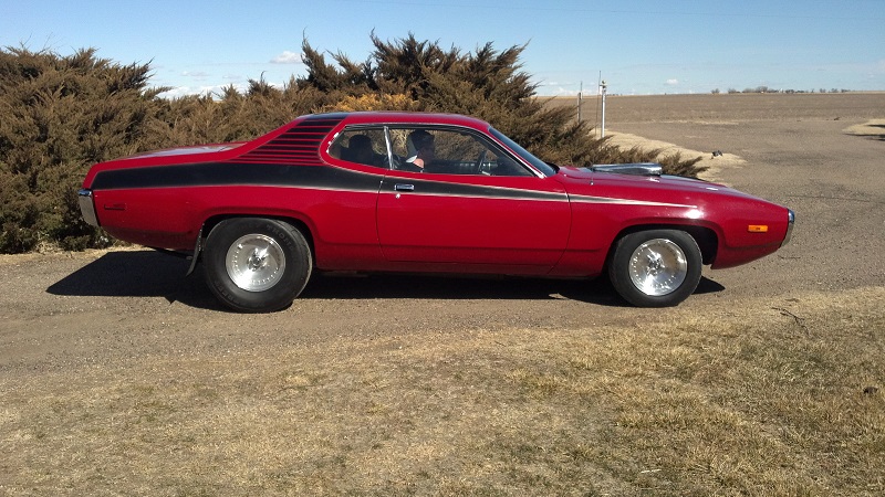

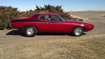

I have 15x8.5" rims with 0" offset. I have 295/60-15 Mickey thompsons and the well is full. I don't know that it is the best size, but it is pretty much the max size without relocating the springs.

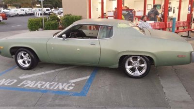

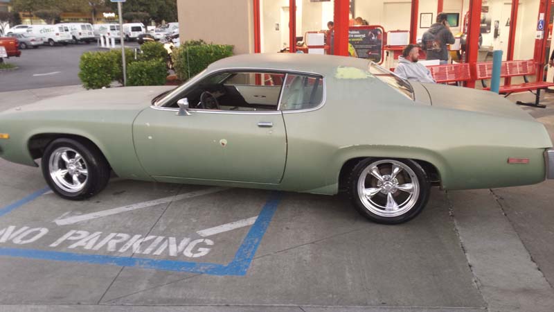

73 Saterllite new wheels.jpgon my 73 SSP I have 18x10 no off set and 295 40R 18 in the back.
