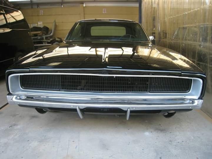

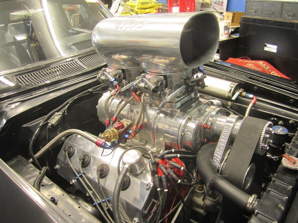

Hi
actually this car is not mine, but my friend in thailand(mine is 68 in the restoring process). The spec of the engine is use to be 426 hemi with 11:1CR but since the fuel quality in our country is maximum 91MON. The engine is broke down. Now we set the new engine wit 8-71 blower boots around 5-7. TDI 6X gearbox and the reargear3.5.and we reduce the CR to 7.5 . The car is not pull that hard as we expect. We really dont know what is the problem. Should we increase the CR. Or any other suggestion .help us out plz.
1st pic is before we put the blower

If the CR is an ACTUAL 7.5:1, I would not increase it if the plan is to run 91 octane fuel without additives. If you have limited the boost to 5-7 lbs.( as verified with a boost gauge), the first thing to check is the carburetors (they do have 'boost' reference power valves, don't they?). By that I mean that you want to 'over jet' the carburetors so that you are on the rich side, and then work backwards from there going by spark plug coloring. It's very easy to lean out a blower motor and destroy pistons. A method to retard timing at higher RPM (several makers of these devices, depending on your ignition system) is also a prudent buy. If you're still looking for more power after all the tuning has been done correctly, you can always up the boost and mix in some race gas. Do you have access to a chassis dyno and a shop that knows how to tune?

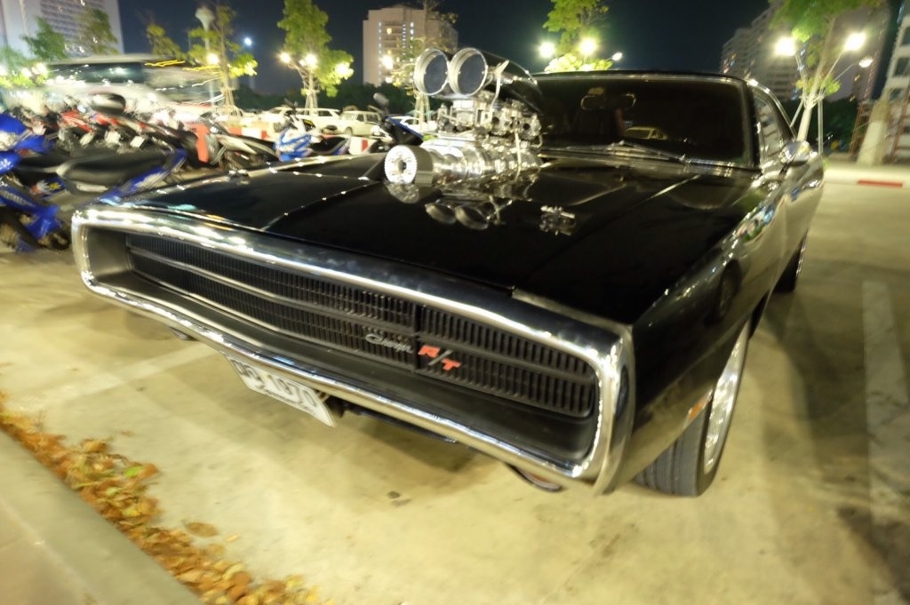

Show me a licence plate on the back of that car from your country.Then maybe I can help
Not meth injection!! Methanol. As in the engine runs on alcohol. The other is water/methanol injection under boost. You can not run 30 psi with 11 to one with that set up.
