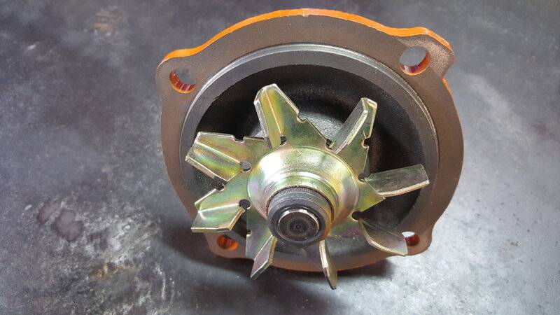

Flowkooler, that is a unique impeller design for sure. They claim it helps cool at idle and low speeds, exactly where my issues are.

I took the Bee out for a ride this afternoon. I installed the Flowkooler water pump last week and wanted to see how it did in the heat. Warm, humid day here in Bethany Beach. 90 degrees and 80+% humidity. Lots of beach traffic.
Temp gauge ran at what is about 190-200 without AC. Turned the AC on and the gauge climbed up to what I would say is about 215 or so. Still not horrible.
When I got home, i immediately got my heat gun out and the top of the radiator was 195. Thermostat housing was 190. Side of the radiator was 200.
In your experience, would you say the 53 year old gauge is likely off or possibly the sending unit? I don't mind changing the sending unit. The gauges though…I may look at Dakota replacements at some point.
Heading to Carlisle in a couple of weeks and the ride back in Sunday beach traffic is going to suck, but if I’m only running 195-200 though the gauge reads warmer, I’m a happy camper.
