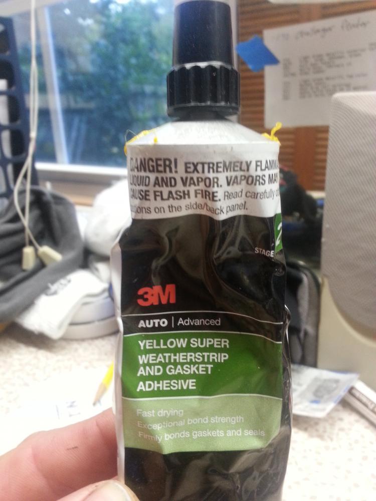

I've used the black stuff and it really didn't harden up completely. The 3M yellow adhesive hardens in about a minute. Problem is it's yellow, and if you're not precise you'll see the yellow. glue.jpg

3M - 8001 Super Weatherstrip Adhesive - they don't call it yellow death for nothing! LOL - It works like a contact cement - get it on both surfaces - pull it apart and then give it a few - put it back together, make sure you have it where you want it - it locks together - may give you a little wiggle room, but it'll lock together and hold! Your weatherstrips will not come off using this - it's good stuff. I've ran across valve cover gaskets that were put on with this stuff - argh!!!!

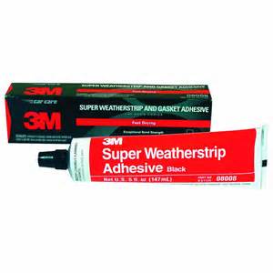

Color doesn't matter (except for matching the weatherstrip color), there are a couple types that 3M makes. I wish I had them here to confirm the part #'s but here's what I found out. I purchased the 3M black adhesive for my seals along the back of the door glass and had so so results, when I was installing the trunk seal I read the directions (I know, hard to believe) and it called for a specific part #. A trip to the parts store confirmed that there was a Super Strength adhesive, same container, same colors just a different # so it matters. It worked allot better (it was yellow but comes in black as well). Found some pics, notice the difference in the labels "SUPER".[ATTACH=CONFIG]187553[/ATTACH]thCAE0TFBY.jpg
