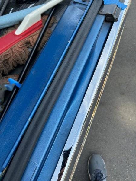

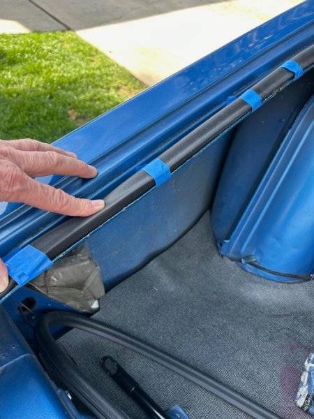

Replacing the ancient trunk weather strip in my 1971 RT. Not sure if the weather strip along the side goes one way or the other. In picture 1, it is laying flat and should work fine. In picture 2 the weather strip is tall and will likely work, too. I think picture 1 is the right way but not sure. Can you help me confirm which way is correct before I put some glue on?

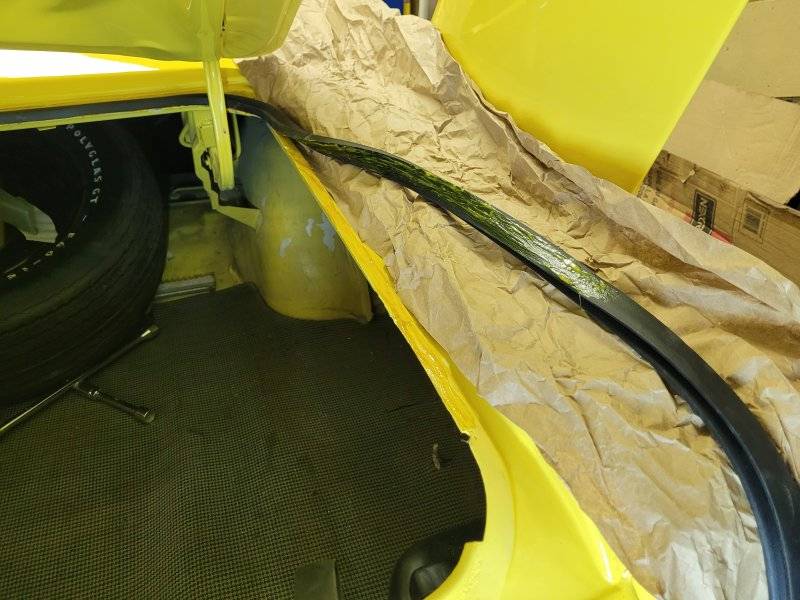

Picture 3 is along the bottom edge. I think it is right.

I could be wrong here but I think pic 1 is correct.

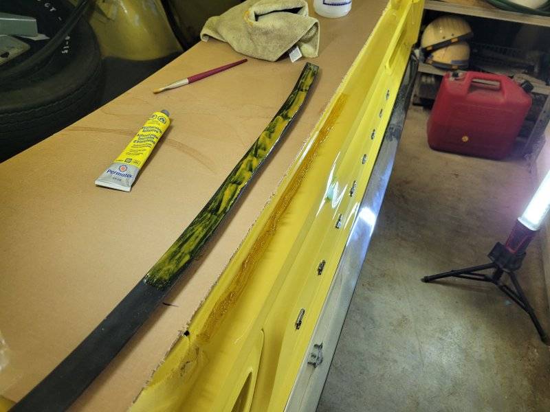

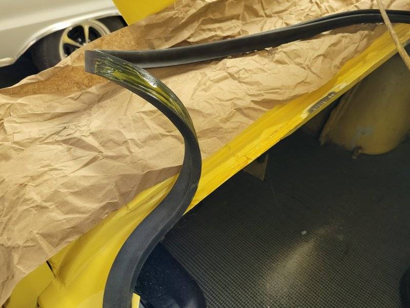

Permatex Weather Strip Adhesive. It's yellow just like factory and just like contact cement. Coat both sides, let sit 10 minutes and stick! Which ever direction you work best, do 1/2 the lower trunk edge to the corner... STICK... do the corner.. Stick.. do a side.. STICK. You get the idea!
ZERO tape required nor 100 clothes pins!
