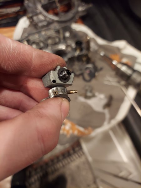

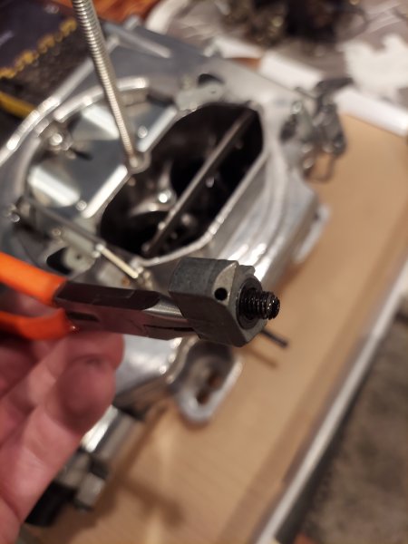

What you are looking is not the squirter hole size. Look closer
Look at the shape .....
The edelbrock has a venturi effect. The tube is larger then tapers down to smaller before discharge. Can't tell what the demon does.
