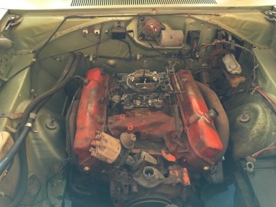

I recently did this in a survivor 69 roadrunner
oops, Got to get glasses,, I was thinking small block rear freeze plugs.

I had to tamper with this survivor roadrunner to do them. Sucked
