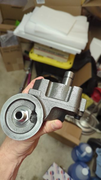

My oil pump on the Fury is weeping/leaking from the joint between the pump and the filter cover/adaptor, a first for me. Is this the right o ring?

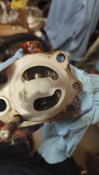

Ok it's apart. And then it looks like it's the little o ring that was leaking based on external leak

The filter adaptor has some light scoring that I can catch with my fingernail, any concern? Dress it down?
Time spent chasing the issue and peace of mind knowing you won't need to again soon are worth the $$$. :thumbsup:
i've found thru the years that some pumps have round o-rings and some are square. they don't interchange.
yup, as I looked at this more, the pump housing seemed to have lathe cut/square ones, they were nothing like the ones that came in the kit. So, after learning a few things, I put the new pump on it. Seemed leak free in a 10min idle in the garage.
