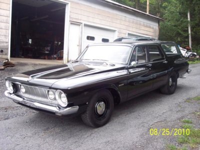

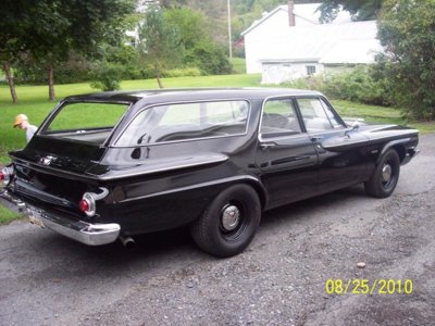

Paging @62MAX , he has a gorgeous 62 wagon with a bunch of tire under it.
This one,275/60 15 rear,225/70 15 front,1/2",15x7 wheel front,15x8 wheel rear, clearance to spring 1/2",to top of wheel opening 1",Dana 60 rear.

My car couldn't use ANY of those, lowered another two inches. With a 62 wagon, you have a different fender opening shape, but lowered two inches will bring the fender lip into play. Having the right backspace for your application is CRUCIAL! To get a lot of tire under the fender the wheel HAS to be in the right place. If you have some relatively large wheels that fit , you can take measurements to see where the backspace needs to be, on YOUR car.
On mine, i have three wheels that i use , two with 4 7/8 bs, both 8 1/2, and an 8" with 4"bs. One set of 4 7/8 needs a 3/8 spacer, because of the section width of the tire, the smaller tire on a wheel with the same backspace fits fine without. The eight inch wheel has a tire that is at least two sizes smaller, simply because the wrong bs moves the tire closer to the fender (the larger the backspace number, the closer to the spring, smaller bs number , closer to the fender)
My big tires, the ones on the centerlines, have about a finger between the fender and the tire, and about the same to the spring. Lowering the body even an inch, the fender would be sitting on the tire. Frankly, the lower you go, the less tire that will fit.
