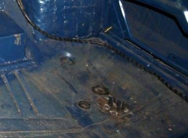

Here are some progress pics of the back seat area. I don't have any real close ups on the work because I bought the car this way, so it was never something much of interest... most are before/during the interior cleanup to resolve some issues / exposed raw sheetmetal the previous owner left behind.

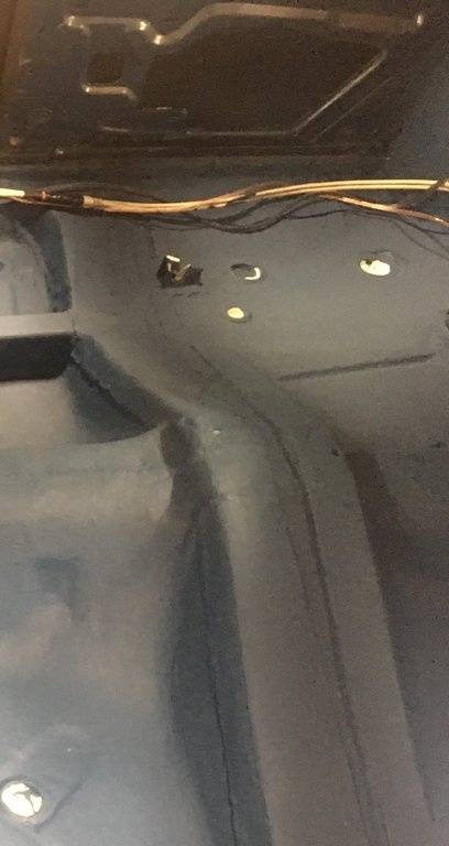

In this photo you can see seat mount on the floor pan and what I believe is the original mounting position just aft...

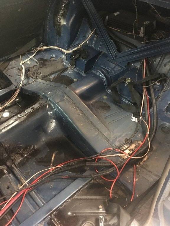

This photos a mess but you can clearly see how far forward the seat mounts were moved on the floor pan...

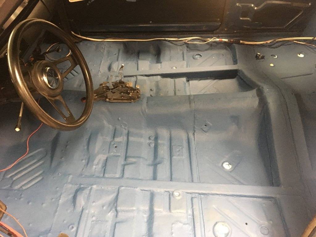

This is after the last coat of my homemade Lizard Skin...

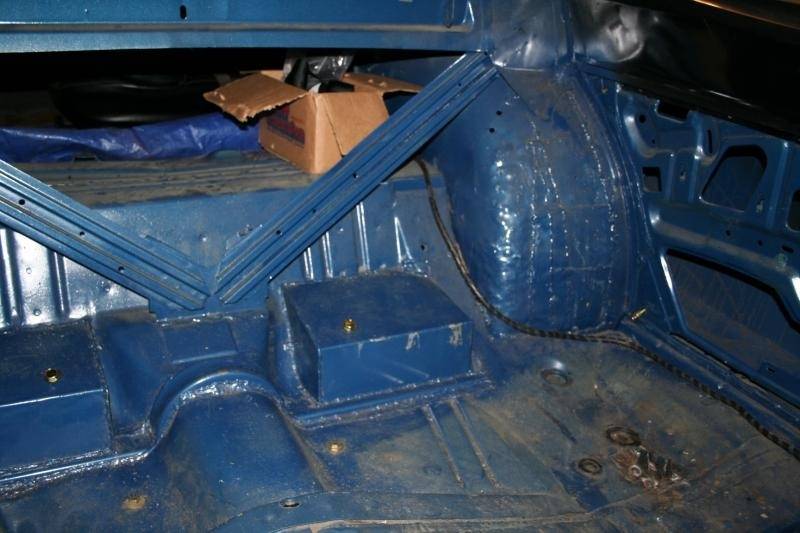

Here's a big picture view - in the pic I still had some work to do, but it shows you how things sit in relation to each other. Here you can see the seat back mounts appear to be in the stock position (to me anyway). You can see the minitub and the 'massaging' the PO did to the wheel houses. The boxes house the forward mounts for the 4 link and the seatback rests on the wheel houses and don't quite reach the 4 link boxes...

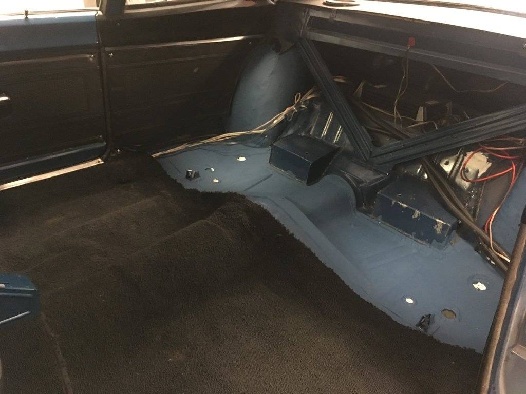

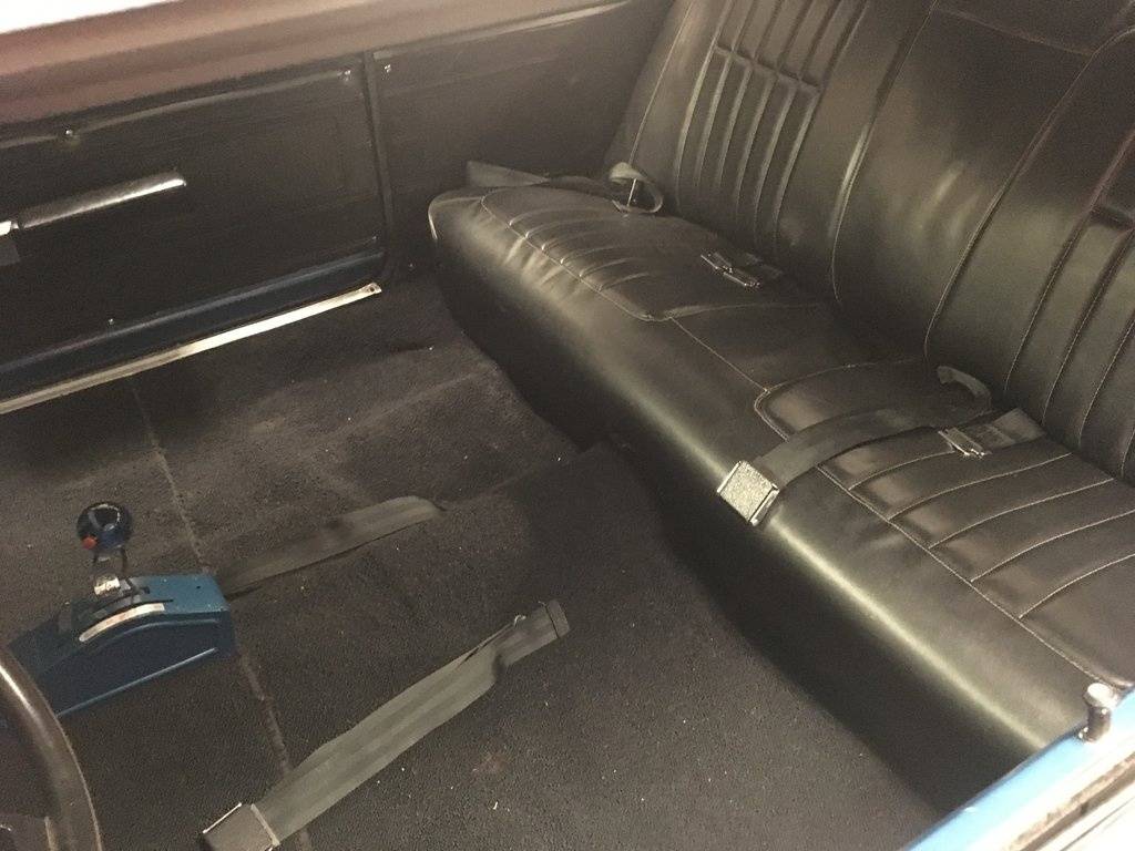

Here you see it all fits together nicely - with the new forward seat bottom position pushing the seat bottom within maybe 2 inches of the doors. Still not so forward that the seat bottom separates from the seat back...
