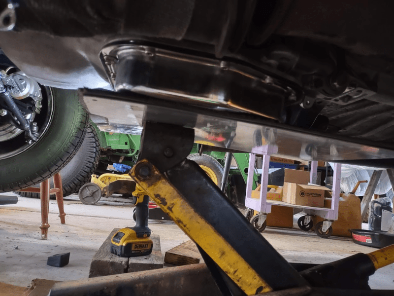

For last couple transmissions I used a piece of plywood with a carriage bolt on the floor jack to replace the normal "cup".
But the bolt was eating into the wood and it was getting floppy on the jack.
So to install it we made this:
It went right in and I got four bolts in.

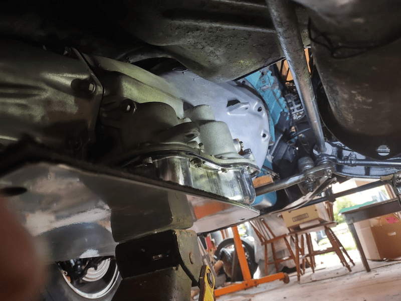

At least this one looks smaller so I bring it over and loctite the bolts on the crank and torque them to spec.
Jack it up and bolt it in.

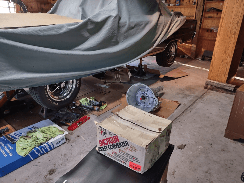

Earlier this spring I bought a NOS Hurst shotgun torque converter from @Big bill.
My friend Dave who built the transmission in my Charger gladly agreed to rebuild the transmission in the Plymouth.

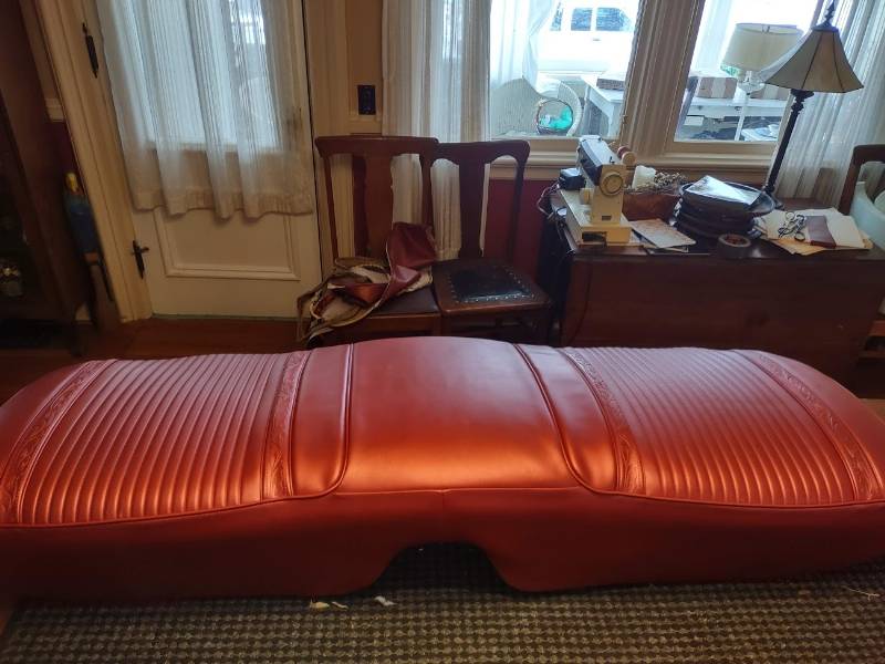

So it was over 2 years ago that I decided to order seat covers for the back seat.
The ones on the front were from PUI (via Summit Racing).
Well these took like 19 months to finally get produced and delivered.
Holy slow delivery Batman: WOW, thought they would never ship these: 581 days ago I ordered this

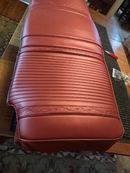

Before I took the car for winter storage I pulled out the back seat so I could work on it over the winter.

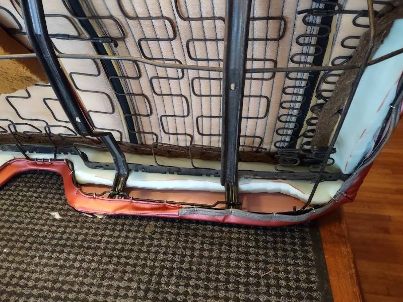

Last week I redid the rear with new foam.
The original burlap with fine wires running the length inside was not re-useable.
The cording on the ends was ripping.
So I decided to cut down the old cover and hogring it to the top of the frame as a base.
My brother picked up some extra 1-1/2" foam as he was doing the seats on his 65 Coronet.
The bottom turned out perfectly.
The top had all the original burlap and padding but it was not full enough under the cover so I bought a mattress foam topper and added it beneath the cover.
Not quite as nice as the bottom but it will do.
