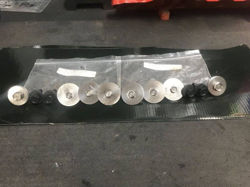

Back at it tonight for a bit. Rear inner splash shield bots and screws. A bit of nickel plating and black phosphate dipping.

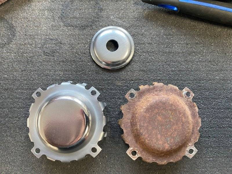

Been a few months thought I would throw in a little update. I wasn't a fan of the zinc process hence a lot of nickel plating being done. Well i picked up one of those benchtop power supplies, and a little coffee cup heater to heat up the acetate. Well I gave the zinc another go seeing as I can adjust the amps now. I think my power adapter was putting out too much power giving the finish a really dull finish. Anyway I give it another try this afternoon and was quite impressed. I still gave it a little brush with scotch pad then a slight polish with some Mothers. I was really happy with the results. Here's a picture of two of my center cap retaining springs/clips for the Roadrunner. One done and one not touched. They both looked the same at around 3 pm this afternoon. I also did a washer for the rear shocks.
