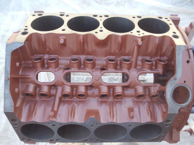

I also "prep" many hard to paint metal objects with Naval Jelly (then rinse it off), it removes the surface rust and keeps rust from returning long enough to get things painted. And it makes the surface super clean.
