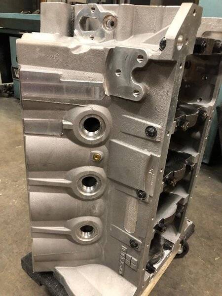

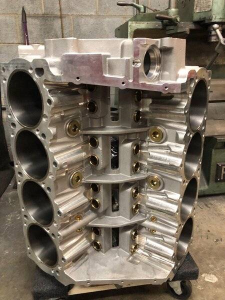

I have a BMP aluminum block at the shop that is going to do the build eventually. They retail for $5800. The RB block (like mine) and Hemi block will take a 4.5" stroke with no clearancing required. They are probably available to ship immediately.

That's a sweet looking block!

Thank you.
Bill Mitchell Products "reworked" the design, and they come only needing lifter bores honed to size, line hone mains, deck and bore.
Now I see the lifter bore "sleeves" in place, and I believe the ductile iron cylinder sleeves come at 4.49 (on the big bore block I got, but they also have a small bore 4.24" IIRC? available, maybe better for a boosted or lots of Nitrous application?)
So I'm guessing the cylinder sleeves get a "clean up" bore, but my point is they don't need major machining to correct a myriad of problems like "some other" blocks have.
