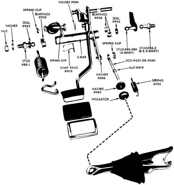

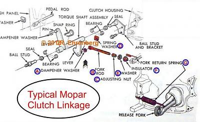

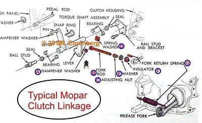

linkage photos, not sure if this will help or not, couldn't hurt
thanks bud, any chance a pic of that ball stud inside the bell?

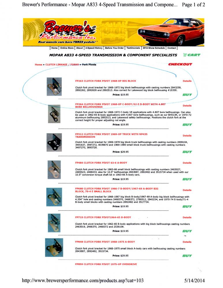

Here you go from Brewer's Performance site. It is actually a pivot for the arm verses a ball stud.

I found out that you have to have the right pivot for the clutch fork you are using. There are 3-4 different off-sets from the mounting bolts That really had me stumped before I found that out...A phone call to Brewers taught me that........................MO
all working good now, cut some of the thread off the bellhousing ball stud and screws in all the way now, installed the pivot bracket, all good thanks all
