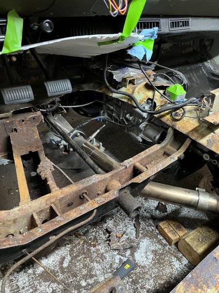

I added photo from when I was doing the floors a few months ago. It might give you a better idea as to where everything fits and how it goes together.
I have Quick Time SFI-approved bellhousing on my '66 Satellite and it seems to have plenty of room. I have a small-block 360 with a TKX. My TKX is right up against the trans crossmember and I cut the tunnel in on one small spot to give it a little clearance, but the bellhousing was never an issue. I'm sure RBs are different, but I would be surprised if it was enough to cause problems. I added photo from when I was doing the floors a few months ago. It might give you a better idea as to where everything fits and how it goes together. View attachment 1682501
