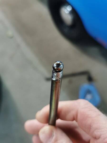

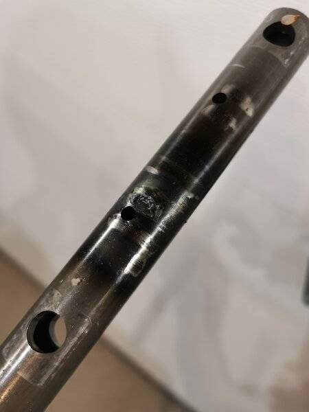

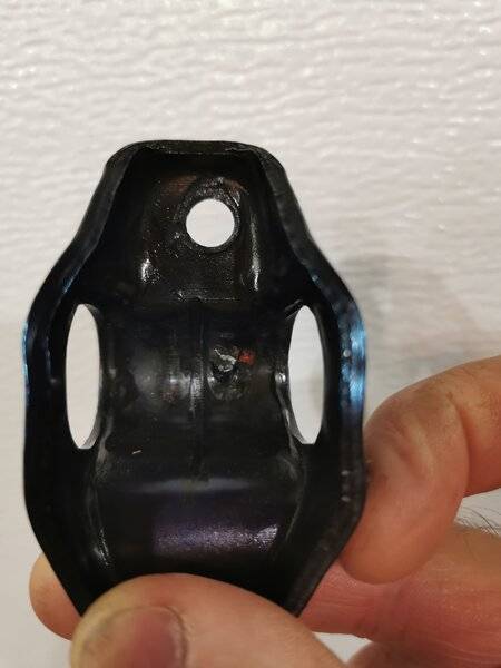

The rocker wasn't stuck to the shaft, but it seriously gouged the shaft. They very obviously became almost fused together for a short period of time which I assume is why the rocker stopped pivoting, allowing the pushrod to just blast a hole though the rocker. The shaft, rocker, and pushrod are all being replaced.

Here are pics of the damage on the rocker shaft, rocker and pushrod. I don't actually see a lack of lubrication as the problem. The oil holes in the shaft are clear, at least they are now. Either way, the shaft and rocker are pretty galled up. I have the new pushrod and rocker, but the shaft I have to get a used one from a local Mopar restorer. I'll check for straight, and if it looks good, I'll grab it. By Saturday afternoon I should have it back together.

If you don't see that failure as a lack of lubrication then you need to get your eyes checked...
The pushrod didn't punch through the rocker because the rocker stuck to the shaft...it punched through because the ball socket got hot due to lack of lubrication & the metal got hot enough that the pushrod easily punched through....
That blue/black color shows heat, lots of it... The rocker to either side looks normal, they were operating under the same conditions accept they had oil..
Well my eyes are just fine, thanks. I'll clarify my comment. At a certain point, friction will overcome lubrication. I found no blockage in the shaft. Also, having spoken to a few professional engine builders, I've been told several stories of failure of modern stamped rockers, and rocker shafts due to poor heat treatment and/or simply poor quality materials. If the heat treatment was poor, the friction would heat the area beyond what the oil could overcome. I'm not ruling out a lack of lubrication, but blue generally means about 650F degrees, and the oil will likely not be effective at those temps. Conventional oil starts to burn at between 350-450F. Also, since the #2 intake rocker is second from the end of the shaft, and the exhaust rocker was fine, oil was certainly getting to the end of the shaft. Either way, I'll be swapping the new pieces in Saturday, and hoping for the best. it snowed locally yesterday, and I really need to get this car in to storage.
