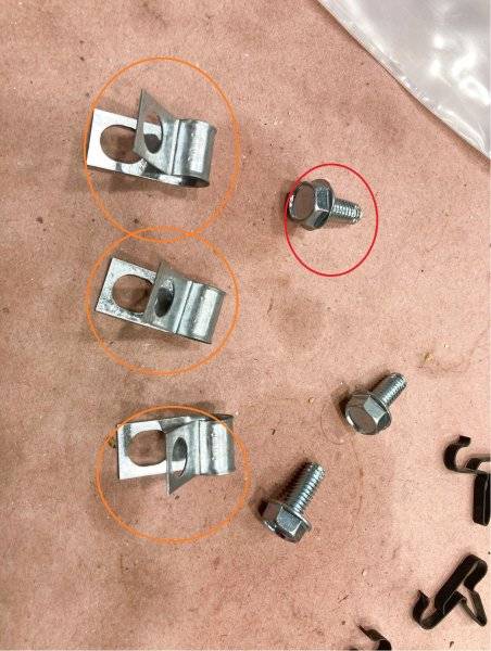

Trying to determine where these clips go for the fuel line from the tank to engine (Orange circle). I bought a "kit" and came with these. The Service book is void of information for the body fuel line. I understand where the other "pop in" clips go and are no issue. Just these. Also the screws supplied (red circle) don't seem correct either. Seems like they would have sheet metal threads with a hex head. No threaded holes along the fuel line path that I can find.
Any help and pics would be greatly appreciated.
One above the tank towards the passenger side and outside face of the frame rail in the passenger wheel well.
Thanks! Should sheet metal screws and not these machine screws? Is that the front or Rear wheel well? I assuming the rear.
Those bolts aren't OE correct but they'll work. Fuel lines and brake lines all fully covered in my Bee restoration. Front OF the rear wheel well.
Perfect and thank you for your help. I am aware of your resto link at B-bodies Only but forgot about charger forum. I looked for the clamp with the screw in the service manual but didn't see them, only the clips. Suprised there is such little info on that and the body fuel line routing. Mine was off the car when it was bought, so have no reference available.
