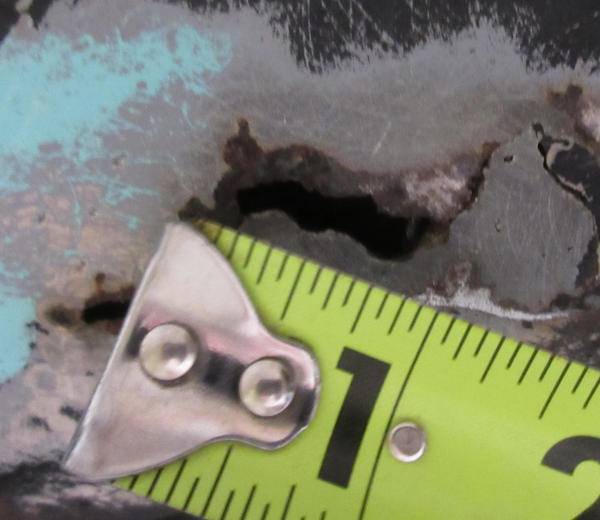

I've got a few holes like this one -
Can this be bridged with fiberglass bondo alone, or does it need a mesh support under it? How thick should the bondo be?

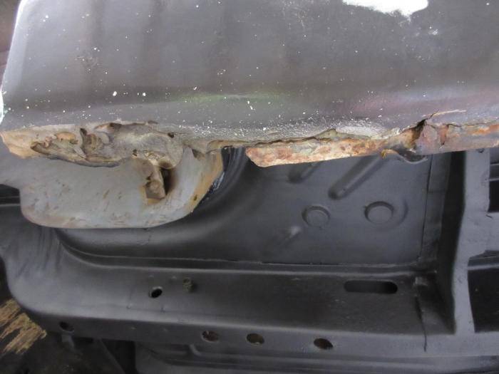

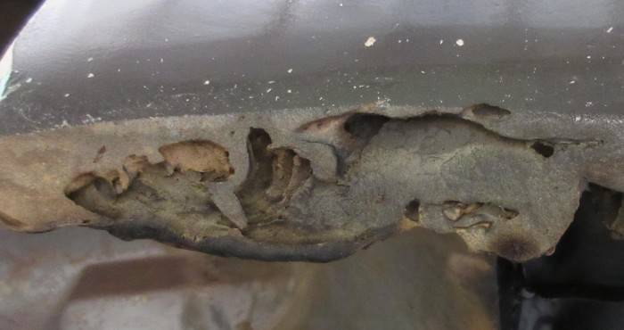

I've also got this mess -
View attachment 1340288View attachment 1340293
It's all going to be replaced, so no need for perfection. Just a reasonable amount of improvement.

I've got some of the U-POL adhesive. Let's just say I reserve the right to go that route, but I know what's going to happen if I do - it's going to expand to include trunk floor extensions, and then I'm going to get the full mushroom cloud when I "might as well do mini-tubs while I'm in there."
SEM patch panel adhesive
if it's like the norton stuff, it's water proof and corrosion resistant.......I use the 5 minute and mix it like body filler.....use it to fill the holes, it will last a long time.......I always have it on my bench, it's good for all kinds of stuff
Patch it up and move on. It’ll probably outlast you.
