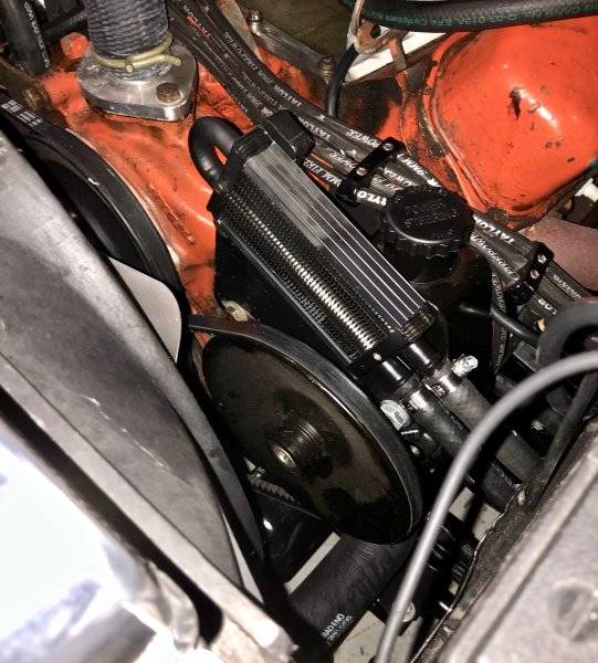

I have the hissing noise too, had it from day one. Cooler installed.
I installed a cooler when I first did the install, and it has worked flawlessly. But, after about 3,000 miles, it has started to hiss.
How long ago did you purchase the box? Is the hissing sound coming from the Borgeson box or from the pump?
Jan 2023.
Hard to know which one makes the sound, though my FF box had no hissing noise.
I bought mine from Peter. I hear it in the cabin, so I think it comes from the box. It's not to obtrusive to me, but a friend who installed one in his 68 Barracuda is very aggravated.
