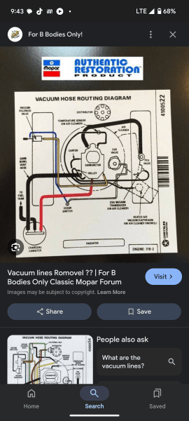

Does this look right?
Awesome, I'll start getting those together this weekend, I believe all I need now to get it to run is to wire the distributor to the "run" wire as well as the "start" wire
