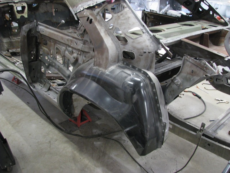

I know you guys say to brace everything, some building giant racks and all, and I agree to a point. But I am new to mopars, so I am still getting the hang of this. But then I come across a build like this and I didnt see a single brace anywhere, they built the entire thing on jack stands!
Any comments about it are greatly welcomed! Thanks!
http://www.macleanclassics.com/1968chargerrtresto.htm
Measure measure measure and then measure some more. Its obviosly doable, but it helps to be experienced. Obviosly not these guys first rodeo.
I agree that isn't there first time, I have done a ton of rough cars, lots of late 20' to late 30's stuff, It can be done with no jig or a ton of bracing, but as Hemi Rebel said measure measure measure, I have a chassis jig i use for building frame and such , and it makes things a ton easier when you have something mounted solid, mind you you still have to measure alot because when you welding things ,move around its nice to have it braced.
