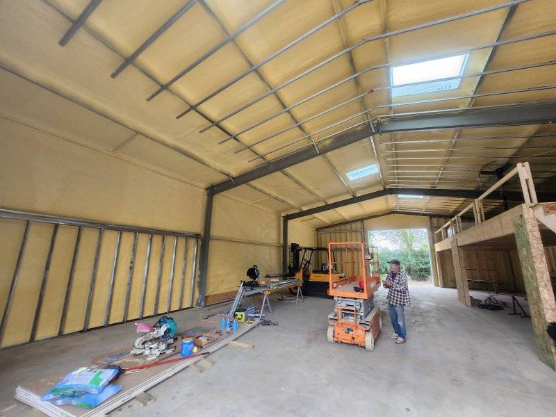

i got this done for $ 7200 and will seal better than you can ever get batt insulation, I've been in construction for 35 years and have seen it. if your paying to heat your shop it will pay for itself, I didn't do my own house cause it was crazy expensive then, regretted it ever since this is about 5000 sq. ft of surface area. but I understand these buildings add up and money savings are essential, i was just throwing it out there. good luck

I will be creating dead air space when I install osb on the walls, and drywall on the ceiling, the osb will be sealed together when installed. With my application with the iron building and the metal framing it creates about 12" of dead air space, which is free insulation on top of the foam.

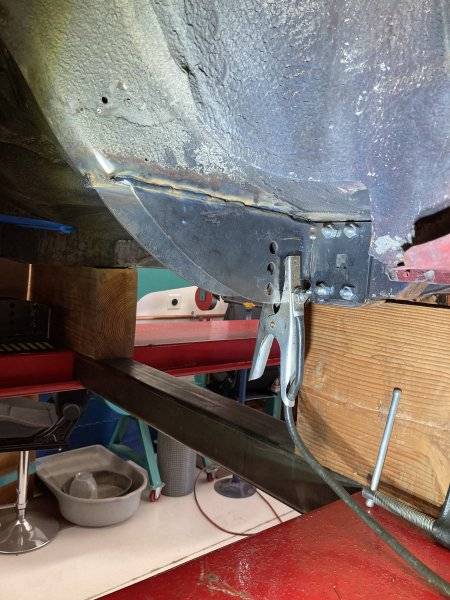

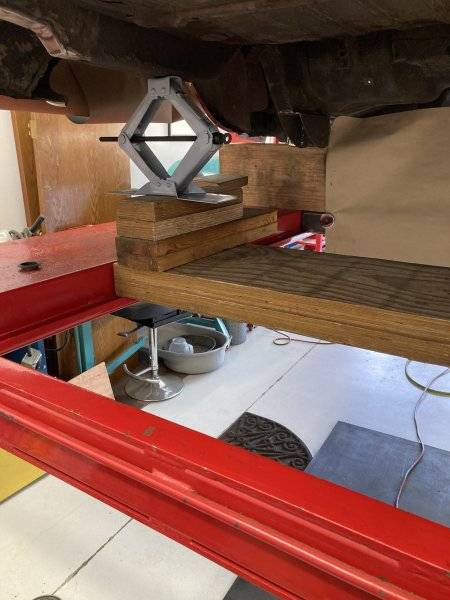

For those with the 4 post lifts and rolling jacks, or those wanting said units, here is something to add on. For mine I wanted some crossbeams to support the cars when under as sometimes you want all four wheels off of the ramps. For one pair of beams, I got ahold of some remnant 4X6 .187 wall rectangle and notched the ends so they would fit sown onto the jack runways and support the car. On top of those you add your cribbing. Also some of the remnant parralam's that were used in construction of the garage get used for that too.

For those with the 4 post lifts and rolling jacks, or those wanting said units, here is something to add on. For mine I wanted some crossbeams to support the cars when under as sometimes you want all four wheels off of the ramps. For one pair of beams, I got ahold of some remnant 4X6 .187 wall rectangle and notched the ends so they would fit sown onto the jack runways and support the car. On top of those you add your cribbing. Also some of the remnant parralam's that were used in construction of the garage get used for that too.View attachment 1537239View attachment 1537240
That's a great idea! Will definitely remember that one!
