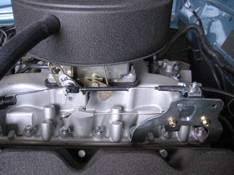

727/904 and yes they fit others. This is Mancini's along with their big block throttle cable/kick down bracket.
Are you talking Kick down and throttle cables ? The photo above uses the factory Mopar throttle cable.
