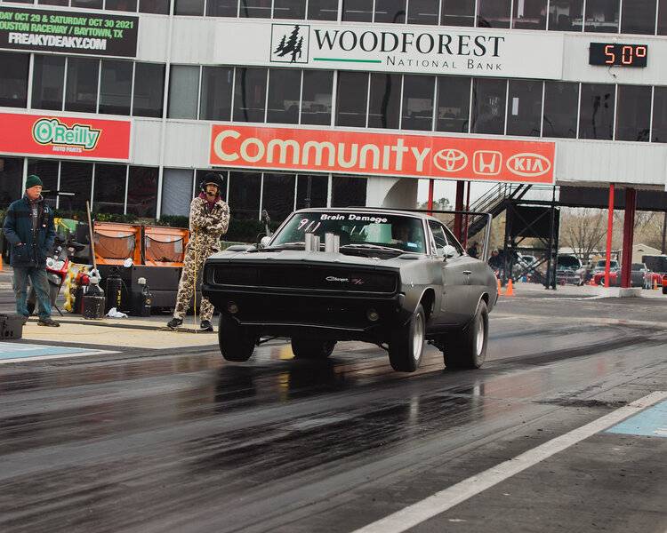

I was sent another picture, Had to share with Y'all, it made all the work on my street car worth it, puts a big ole smile on my face even though I still have the fuel pump issue
Nice shot of the Charger/launch wheels up Charlie/CDR
