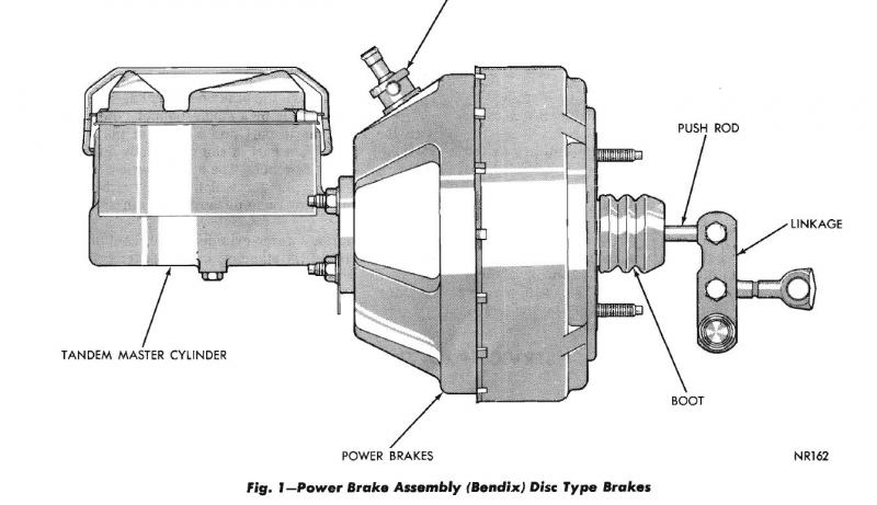

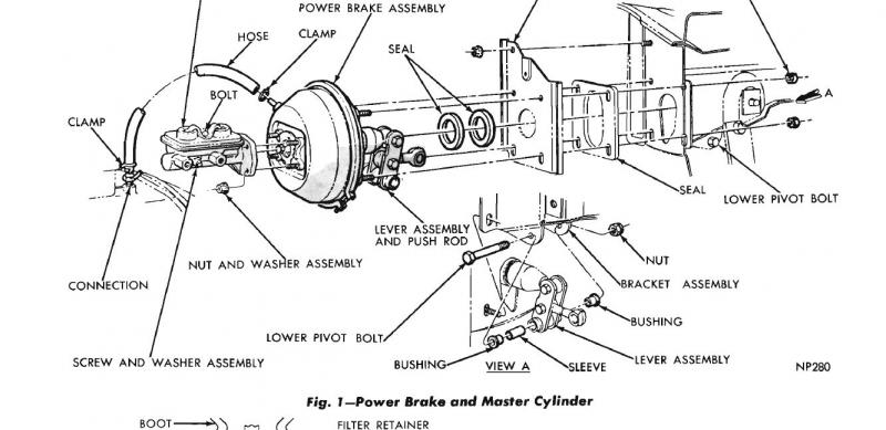

I need to find a parts brake down for a power booster mount / bellcrank.
69 to 70 or later. I Found what it looks like and it seams I am going to need the Bellcrank set up that mounts in the hanger assembly. If you have one that is not rusted to crap let me know. I think I can use a 74/76 year unit also as it may be abit longer and fit my needs ?
Thanks for your help
Tj
http://www.piratejack.net/index.php?page=shop.product_details&flypage=yagendoo_flypage_1.tpl&product_id=397&category_id=49&option=com_virtuemart&Itemid=6&vmcchk=1&Itemid=6

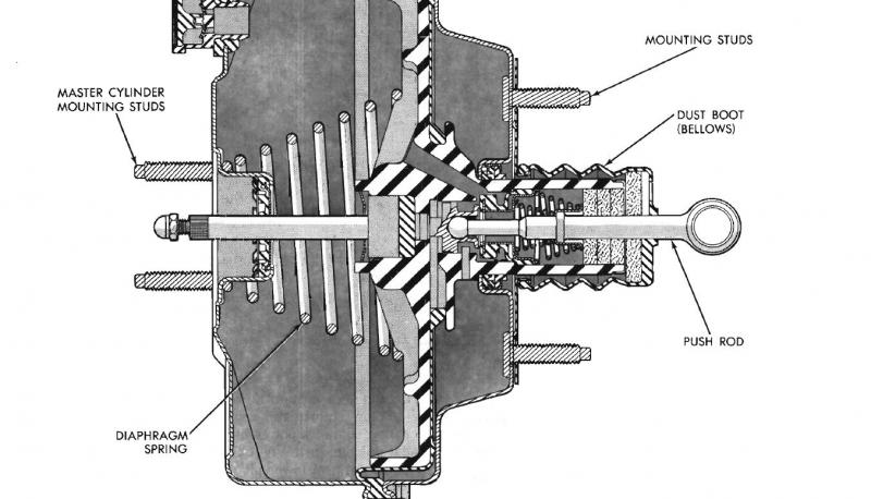

this is what I am looking for .

No sweat. PST carries them as well. Don't know if they sell separate though. Seen you posting in the parts for sale...probably you're best bet. Power drum/drum and power disc/drum are the same for that linkage piece. Have you tried FBBO member Moparparts? Guy has a ton of stuff.

Don't mean to high jack thread but you have such a great picture of the braking system so I have question. On this type of brake mechanism how do you measure pedal ratio? I am looking at switching from power brakes to manual 4 wheel disc just need to be sure it's got the right pedal ratio.
The Pedd=al ratio stays the same . A power brake booster strokes alittle more than the manuel master. All you need to switch over is the outside mounting plate and put the master cyl rod in the stock location on the pedal. You will have to remove the bell crank as a manual master mounts lower.
Hop this help ya out .
OK look at the fire wall and you will see 6 holes well 4 holes and two slots at the bottum. The power booster mounts between the top 4 and a manual mounts between the bottum 4 ( holes / slots)
