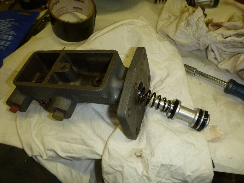

You can, or at least you could, still get a rebuild kit. I was amazed when I pulled mine off Amazon for $32 CANCUK dollars...

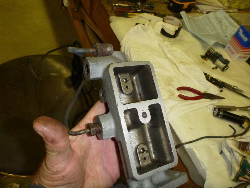

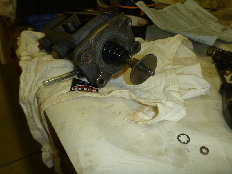

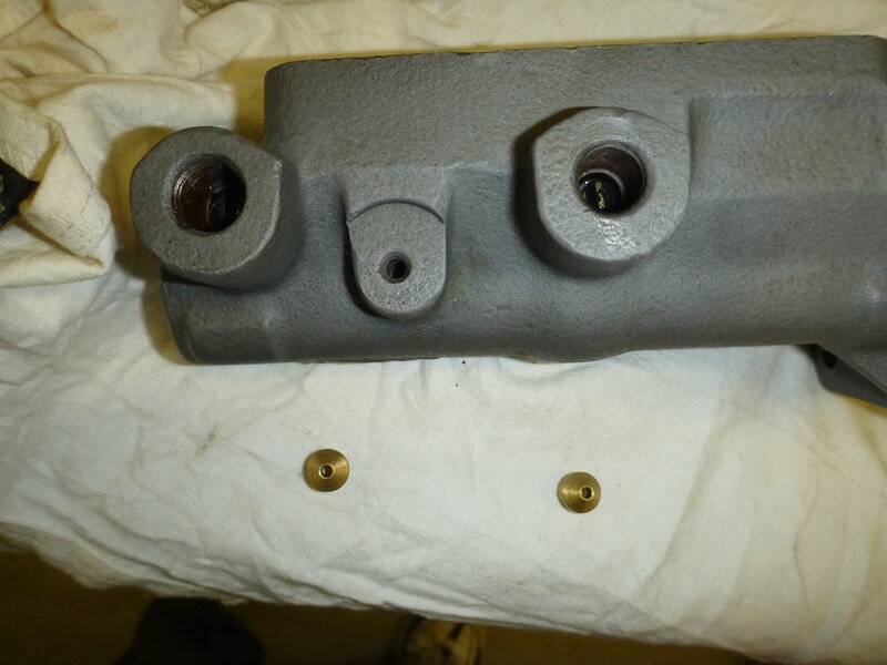

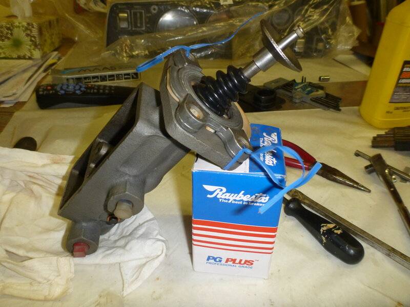

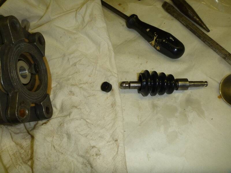

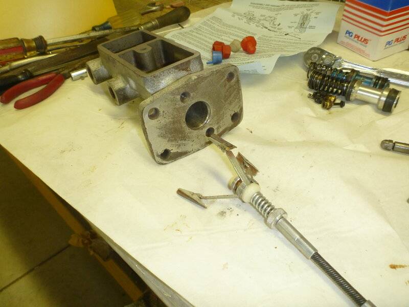

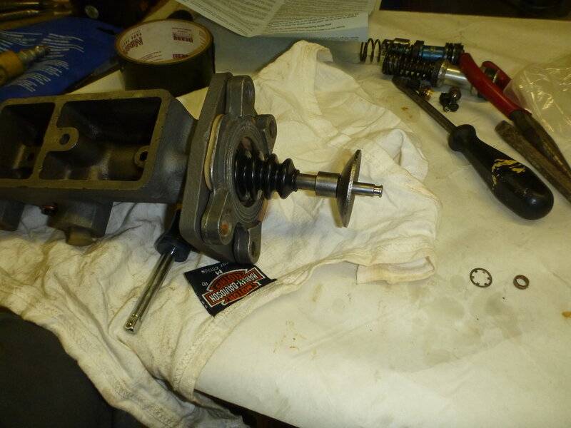

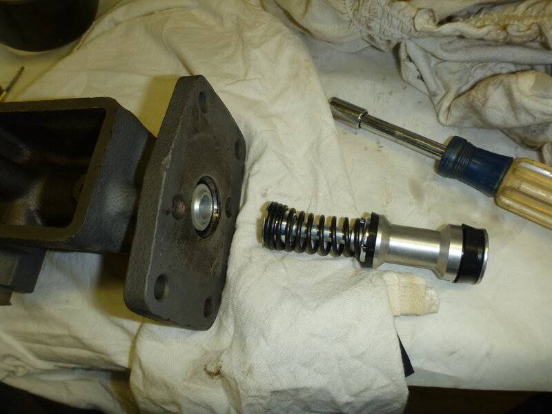

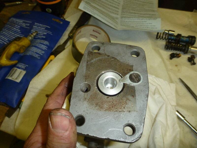

Unbolt master without disconnecting brake lines and have a look see.

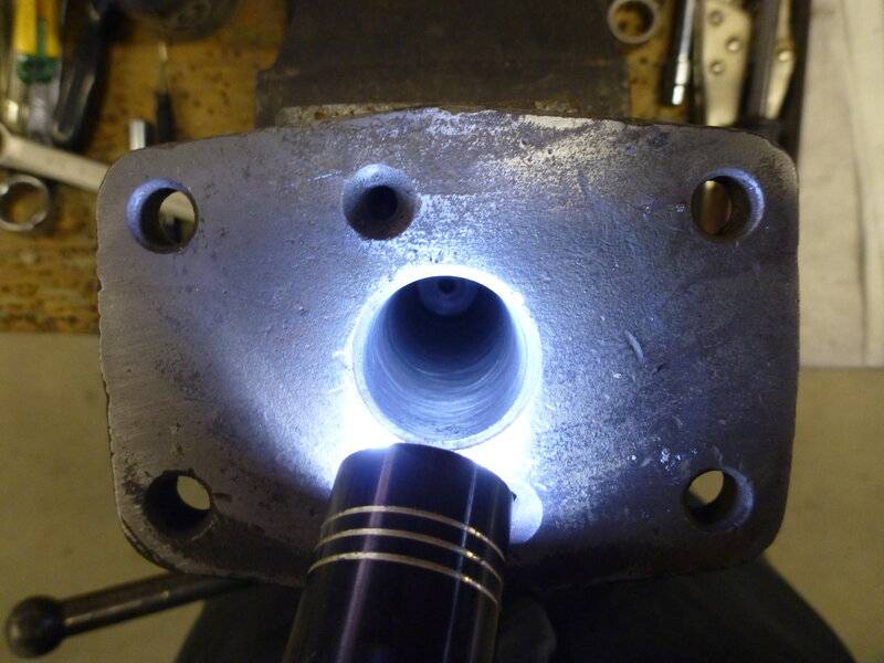

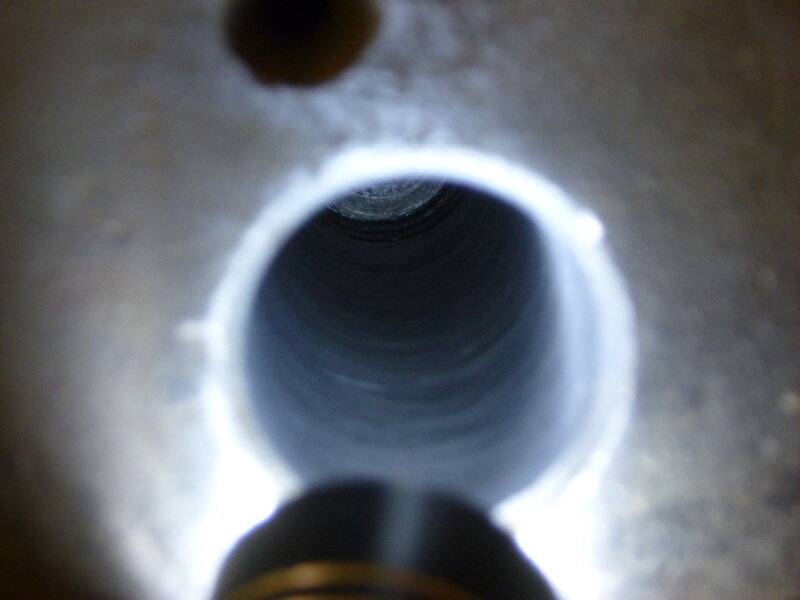

Wayne did you hone bore of master cylinder?
Brake fluid inside an old booster isn't good for the old diaphragm,I would have the booster rebuilt also.
