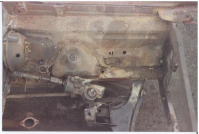

Can you tell by this old scanned picture otherwise it is burried in a box.

Thats a Midland Ross.
Bendix the 2-piece housing twist locks togother. Midland Ross has a band.
Also not sure thats correct for a 70. Thats a M/R single piston. Was it power drum brakes? Disc usually got the Bendix or M/R dual piston.
Looks like the correct Midland Ross PB (kinda hard to tell from the pic), if your car did come factory equipped with power drums. (bendix on the left)

Thanks for all your input, I found out since I am converting to disc, I will need to bendix model anyway. So the quest begins for a clean core to rebuild.
