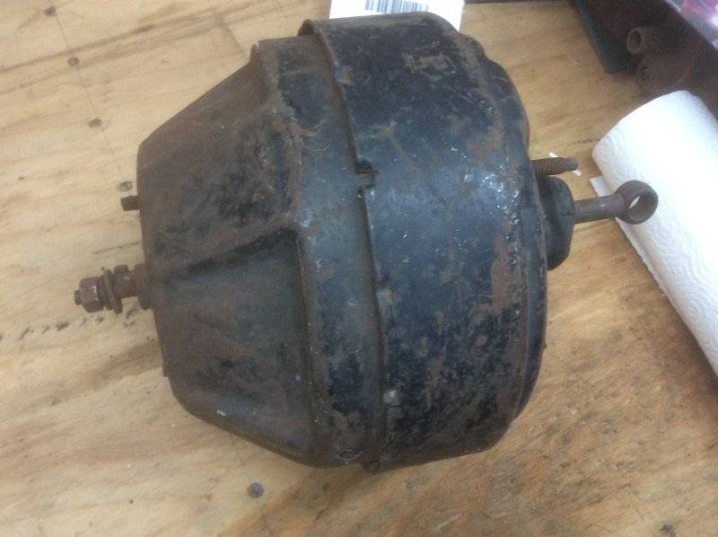

That one on ebay how can you tell if it's single or dual. Bolt pattern firewall side? I have this one needs a rebuild.
Rebuild what you have. The C body unit uses different linkage. You have to have it apart to change them. Is yours a B or C body unit. I think that MBM has the linkage but they might not sell it without buying one of their Chinese reproductions. And I think the Ramman will put the correct stuff in it. I know-a lot of people don't like Wayne, but he knows his Mopar brakes. Call Booster Dewey or Harmon Brakes and get the information from them. I had Harmon rebuild a dual diaphragm A Body Midland and it is beautiful, it looks better than new.

C body pedal side pushrod is different... It can be swapped when the booster is rebuilt...
