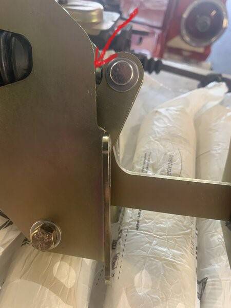

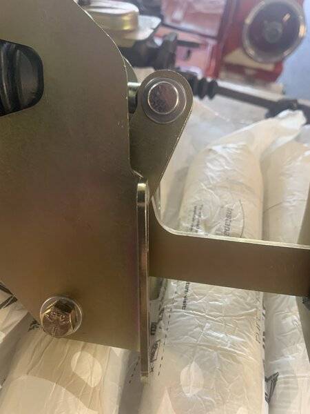

We are currently converting to disk brakes all around on our 69 Bee and our speed shop mechanic who’s doing the job is having issues with mounting the brake booster on the firewall because the push rod arm is not flush with the mounting plate on the booster as seen above. Says this is his first B-body conversion and he’s never seen this issue with boosters ordered for GMs and such. So he is considering cutting the push rod enough to make the protruding arm flush. Does anyone know if that is the correct way to address this issue? Don’t want him cutting anything if there is another way. Thanks.

You have to cut the booster's rear threaded rod just short enough so that lever just clears the firewall
Also make certain it has the short clevis not the long one. The short one is about 1 1/2"

View attachment 1132221 You have to cut the booster's rear threaded rod just short enough so that lever just clears the firewall
Thanks, that’s what we dug up as well. I’ll have to find out if the kit came with a shorter clevis as well. I don’t think it did.
The longer clevis is about 1" longer(2 1/2"), that might be most of your problem
