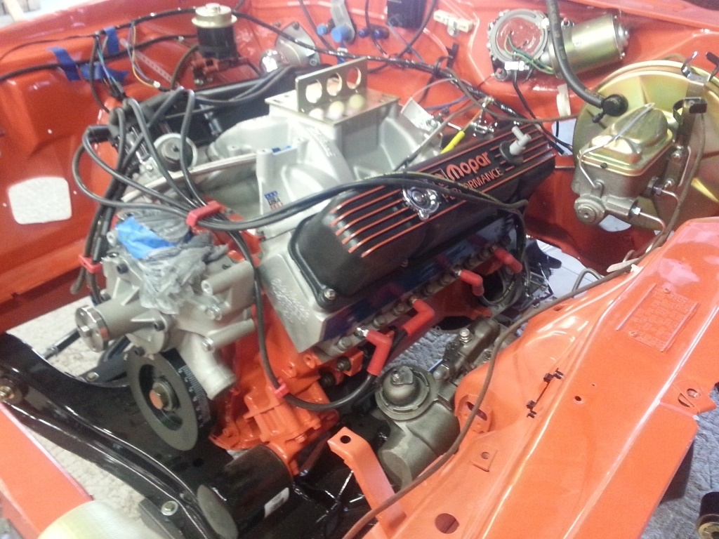

I used Krylon battery protectant and a semi-gloss clear coat.
$18 and two hours labor.
