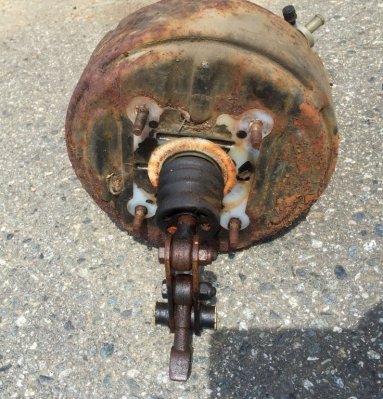

Managed to get that last bolt free with Jim's method of using a long swivel extension and a deep 1/2" socket, though I didn't have to get the dash out first.
I think the worst of the battle is done...
Sending off to Booster Dewey? Mine is heading out Monday
I've already got a replacement unit and M/C sitting on the shelf, though I think I'll get a few bucks back if I send the old core back. Cleaned up and painted the old backing plate and fingers-crossed will get the rest back together tomorrow.
Prior brakes out of Texas did my booster, great job and price with super fast turn around.
I bet 3 bolts will hold it just as good as 4 on the reinstall :)
Just when I thought I was in the clear...
Seems that the plunger cover on the new booster is maybe a 1/16" wider than the stock one, so it won't sit flush against the backing plate and firewall. I guess I'll have to go pick up a dremel and open them up a bit.
