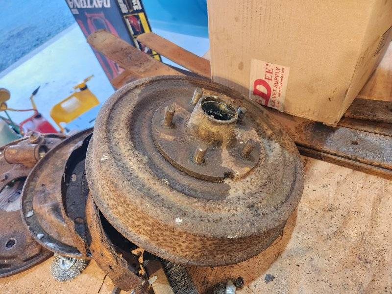

So my passenger side front brake drum is on there like Excalibur. Left one came off with a bit of hammering, not too bad.
Heat, gear jaw puller, hammer time and plenty of it.
It does look to be the original drum, its still has the red paint and long sound dampening spring that goes around the drum.
I've been combing through the forum and seems like some of the bolts are swedged? somebody did this to get them out
For now it seems I need to remove the entire assembly
Does anyone have some super cool trick?
Thank you in advance. Will add some pictures from my phone.

More than likely the studs are swedged. You have to use the appropriate hole saw or drill them out from the back. Search "swedged brake drums"

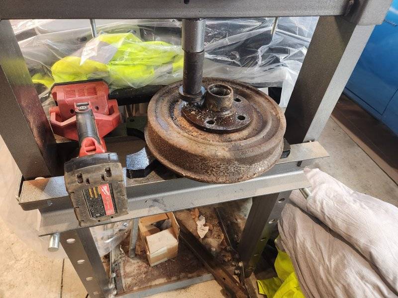

Not sure who's video you posted but you'll notice after pressing, the brake drum was ruined.

Be careful pressing through the hubs with the swedges still on, bad things will happen. You will most likely damage the hub, and or the drum. If you are successful pressing them through, you will probably need oversize wheel studs, or end up tack welding them in.

Swedges are easy to cut. Get an 11/16" hole saw. Remove the center drill bit. The stud will guide the hole saw. Only need to cut about .060" deep. Cut around all five studs and the drum will come off without damaging the hub,

For normal service the drum shouldn't be removed from the hub. If it was, it should be replaced. Especially if the swedges were not cut. It's now more than likely bent. The studs should be replaced as well.
