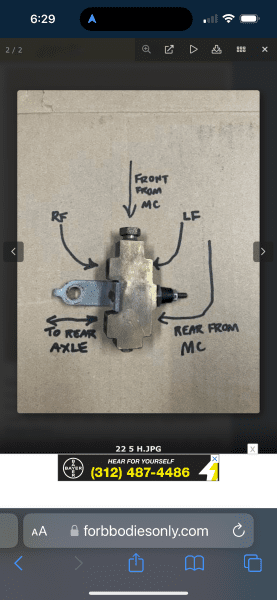

Bad proportion valve? Connections to the portion valve?

I would disconnect the line at the proportioning valve and see if you can blow air through it.
I'll try the disconnecting the line at the proportion valve and make sure that there are no obstruction

I removed the passenger side metal brake line at the proportioning valve. I blew through the metal line and was clear
So Im in the process of replacing the proportioning valve
