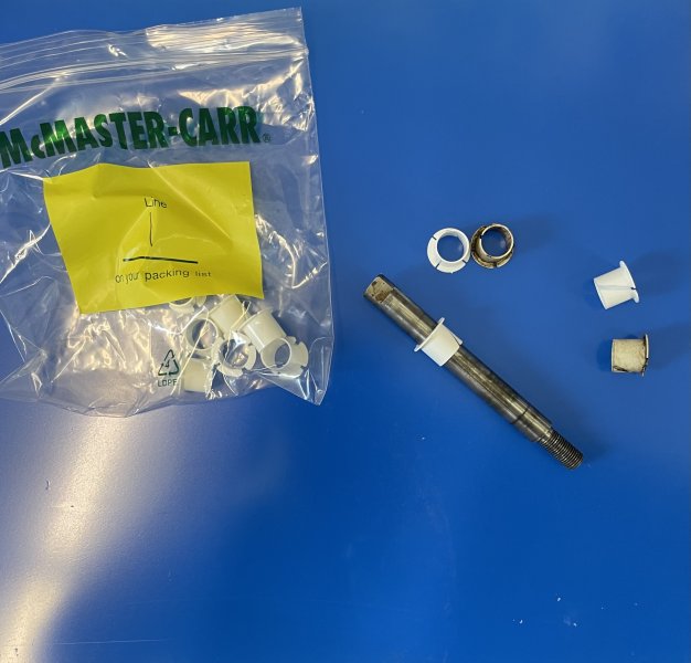

Does anyone know if the brass pedal bushings are still being sold?
If not where can I get an original nylon bushing?
I found an old thread for the brass ones from 2017 but it was closed along time ago.
I’m having a little trouble locating this little part.
Jamie at Mega Parts has them, the plastic bushings. Under transmission, then clutch pedal.
Thank you. I never think to check McMaster-Carr anymore. I used to order from them a lot.
Measured and ordered Tuesday and they arrived today!
These are exactly the same as the original part.
Thanks again 1 Wild R/T , that was a great suggestion.
For anyone that needs them in the future the part number is 1281N18
