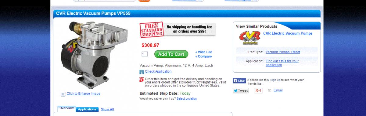

Here's what I run under my battery tray:
http://www.summitracing.com/search/product-line/cvr-electric-vacuum-pumps
Brakes work great.
Prop what kind of set up are you running that in? Engine/cam ?
I'm running a 512 Stroker Jhyatt14. Cam is a solid flat tappet. Duration at 050 inch Lift:244 int./252 exh, 0.520 int./0.540 exh Lobe separation 110. Best engine HG is 8-9 tops. Canister wasn't going to cut it.
You may need a vacuum reservoir and a check valve if not you must run a separate vacuum pump either belt driven or electrical
The electric vacuum pump is $310. I just ended up buying the hydraulic brake boost kit with new master cylinder for $700. I will pull off the current brake booster and master cylinder to sell that as a unit. Hopefully I can get back some of the difference. I'm going to put up a bunch of things for sale once my build is over. I'll just include the booster / master cylinder package in these items. No point in skimping now. Thanks for the advice guys.
