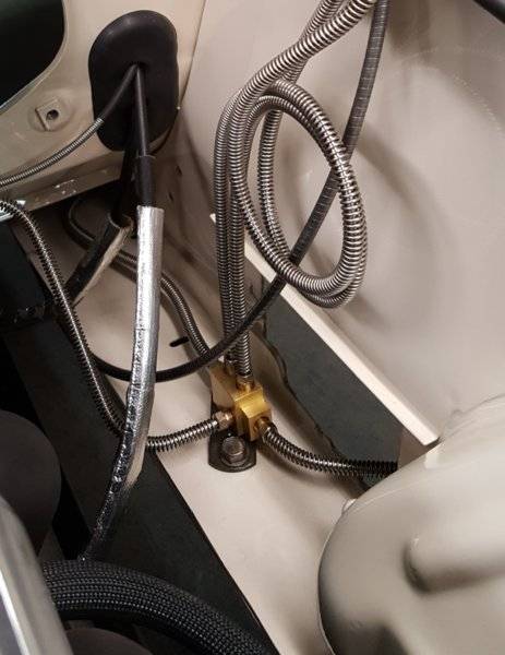

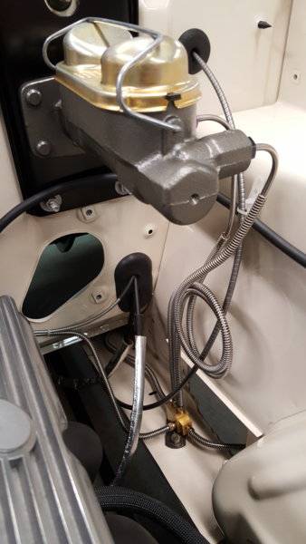

This is how I have my dual master cylinder/four drum block. Only five ports.
